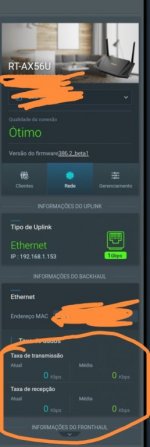

Not work the information only in this router rt-ax56u
