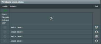

@RMerlin Is this a page formatting error? My long description messes with the columns and stuff.
No, it`s that issue noted in post #2:
VPN Director layout issues when a WireGuard client is running (Fixed in beta 2)
There's an extra </tr> tag in the HTML code when a WG client is enabled.
