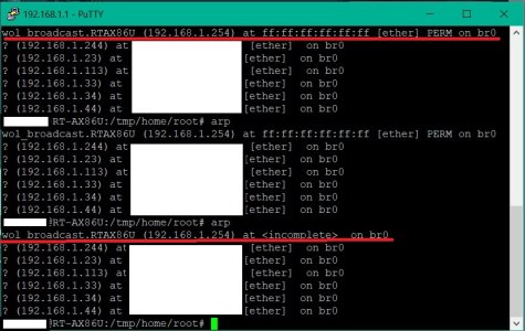

Sorry for my english, google translate. After upgrading from Merlin 388.2alfa1 to 388.2alfa2 or to 388.2beta1, static entries in arp stop being static in fact and after five minutes they go into incomplete status and, accordingly, stop working. The bug manifests itself with any update - dirty and clean. I returned to 388.2alfa1 - everything is fine.

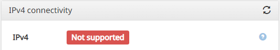

Hmm... IPv6 Native enabled, DNS Director (Router) causing IPv4 test fail:
Is this normal or expected? First time seeing this...
DNS Director off:
Very possibly an error at their end. I have been getting very inconsistent results from ipv6-test recently (approx 4- 6 weeks) - including IPv4 not supported, IPv6 not supported and even IPv4 and IPv6 both not supported at the same time! Any other test tells me that IPv6 is working as expected, plus I can connect to IPv6 only sites - which given I am running dual stack with IPv6 native and DHCP-PD is what I would expect.

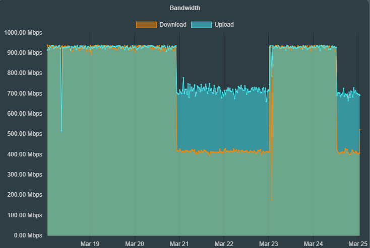

Have symmetic bandwidth 1G fiber with AT&T. Under normal conditions the PC/Ookla Speedtest comes back at ~930Mbs +/- 10Mbps and so does the router whether SPDMerlin or it's own Speedtest.
At random times, the SpeedTest results at the router whether using SPDMerlin or the it's own Speedtest the results come back asymetrical, ~410Mbps +/- 40Mbps on the down and ~650Mbps +/- 50Mbps on the up. I've yet to correlate anything in the log (running Scribe) at the time window that issue happens in. What I can say is that only a reboot fixes it back to normal, so far. Restarting the WAN interface or AT&T modem does not fix it, only a reboot at the router, does not look to be carrier related. When this happens WiFi gets hit as well, and Speedtest results drop by ~150Mbs, but with asymmetrical results where the down is lower than the up. But on the wired devices, its a consistent ~930Mbs +/- 10Mbps in both directions regardless of this drop. This also happend to me with the 388.1 releases but with so many WiFi issues with that release this took a back seat, all the TV's and streaming boxes are wired sny way. But its happening again, before I HW reset the AX88 router and start from scratch, curious if anyone else has run into this situation. Thinking I may just reboot the router and monitor it to capture the different logs at the time the router goes into limp mode, instead. I've yet to disable Skynet temporarily to eliminate it. Plenty of RAM on the router, and CPU is in the single digits also no QoS at play either. Trying to find/locate/capture the bandwidth drop in the log. Looking for way of fixing this without a reboot, but no luck so far.
Looks like this in SPDMerlin, very easy to see normal/abnormal conditions.

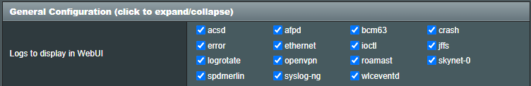

From a Scibe/UIScribe perspective, these filters are active
Any ideas?
Maybe a faulty ethernet connection with the modem and router wan port. You could try replacing the ethernet cable. Also, it wouldn't hurt to test without skynet. Also, make sure you are not use trendmicro and make sure you unaccept its privacy disclaimer.
