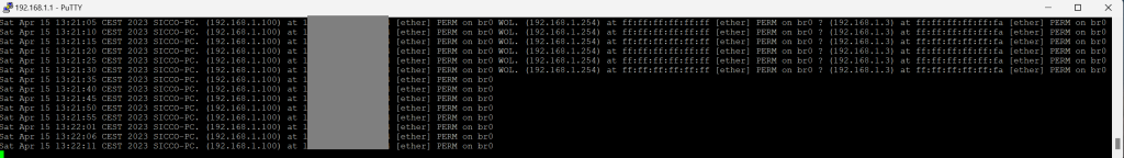

Yeah same here... ive got clean ax86upro and only static dhcp assignments...
Yesterday i was playing around with dhcp / dnsmasq...
Just to share my settings:
My dhcp range:
For mac FF:FF:FF:FF:FF:FF:
First i do for testing (i know :FA and :FD wont work for wol... but its to check when they dissapear):
Bash:
ASUSWRT-Merlin RT-AX86U_PRO 388.2_0 Wed Apr 12 19:43:48 UTC 2023
admin@ROUTER:/tmp/home/root# arp -i br0 -s 192.168.1.100 XX:XX:XX:XX:XX:XX #actual mac
admin@ROUTER:/tmp/home/root# arp -i br0 -s 192.168.1.3 FF:FF:FF:FF:FF:FA
admin@ROUTER:/tmp/home/root# arp -i br0 -s 192.168.1.254 FF:FF:FF:FF:FF:FF
Ive made a simple bash scripts that checks every 5s if PERM arp is still there...
Bash:
#!/bin/bash
while [ true ]
do
  echo $(date) $(arp | grep PERM)
  sleep 5;
done
Result on start:
