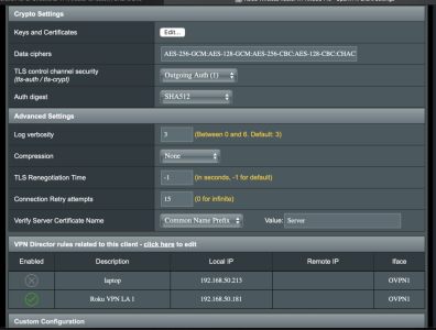

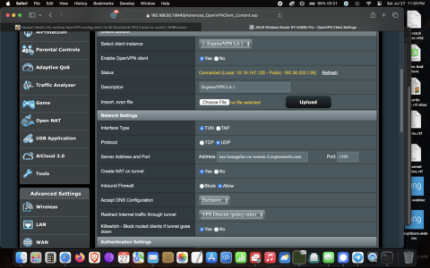

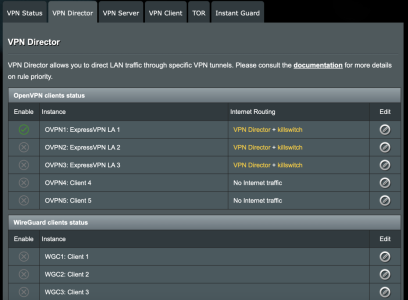

For Asuswrt Merlin Client Routers using VPN Director.
Here is my configuration to make things work on the Client Router:
0) Add rule to VPN Director to route client to server ("Local IP"=empty and "Remote IP"=192.168.11.0/24"), see attached image.
1) Create NAT on Tunnel = YES
2) Inbound Firewall = Allow
3) Redirect Internet traffic through tunnel = VPN Director (policy rules)
See attached images
