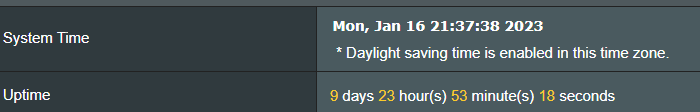

No idea about memory issues.
This is running since the alpha was released pretty much.
I don't use any scripts nor VPN.
