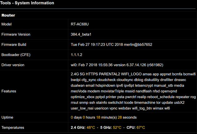

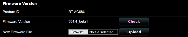

Just upgraded my 68U to the beta2. The firmware version on the web admin page is still showing beta1 though:
Redownloaded the firmware and reupdated, just to make sure, still to no avail. Any other 68U users having the same issue?
Edit: Just fyi, the system info and router upgrade pages are still also showing the firmware as beta1 also:
