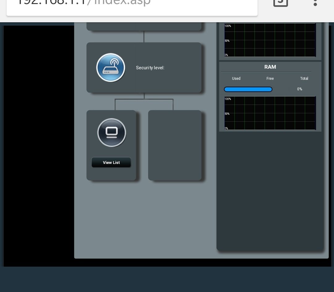

Hi Merlin,
Everything is working fine except mobile browsing.
I don't see other issues.
OpenVPN oke
DHCP oke
Parent controll oke
So thnx for the hard work!
Verstuurd vanaf mijn ONEPLUS A3003 met Tapatalk
