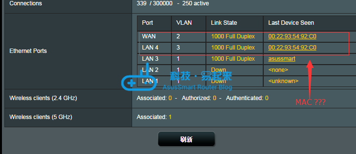

In the tools - Sysinfo, MAC address is not all I have!
