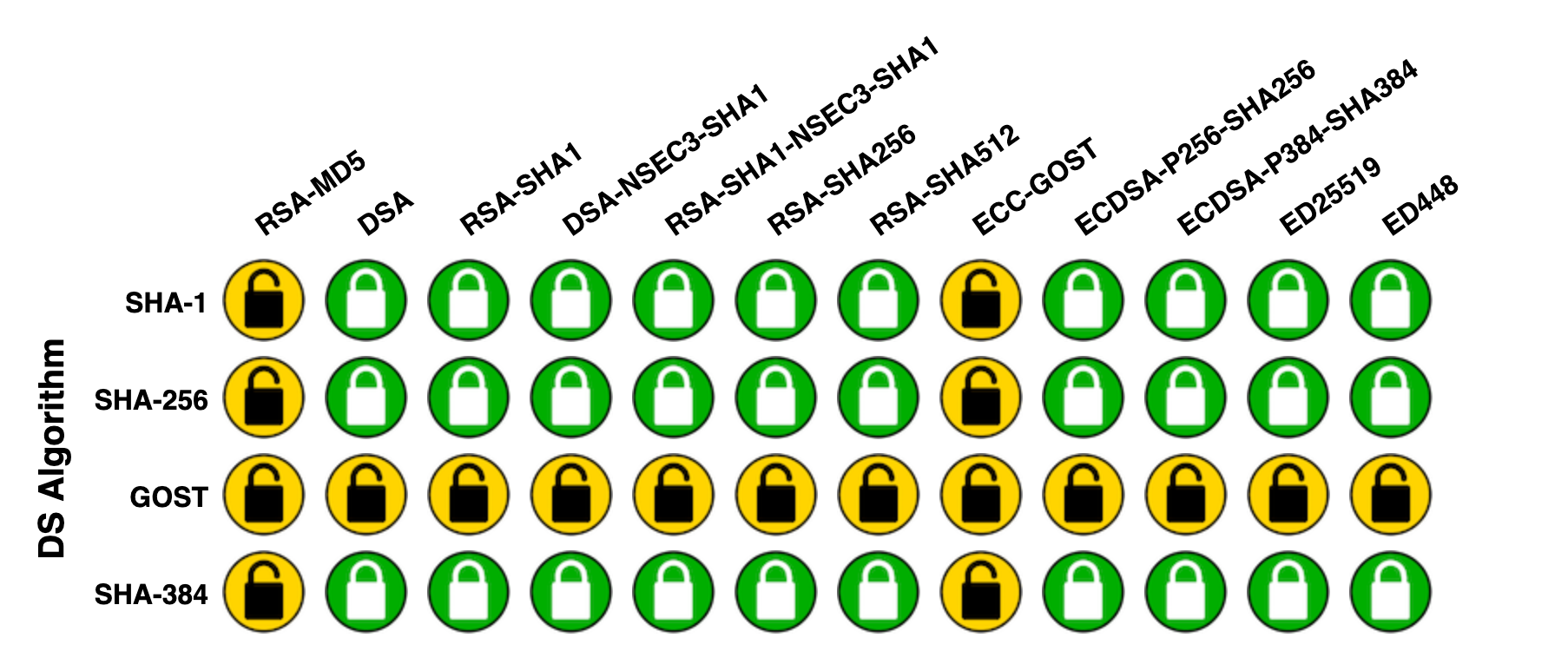

Unfortunately, unbound does not work as intended in 384.13_beta1
Unbound functional now and with Stubby, with the same result in rootcanary. Excellent worked on 384.13_beta1.
