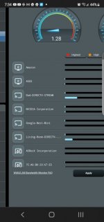

k it looks like its working. my only issue now is i'm trying to get DirecTV Stream connections in the right tin and one of the domains they use when making the rule manually i get a warning saying that it resolves to more then 1 IP address so its only resolving the first one? how do add a wildcard or something?
this is the domain
api.cld.dtvce.com
i tried just doing dtvce.com and also *.dtvce.com but i dont think its working cuz its not part of the output of the grep of the log file...
this is the domain
api.cld.dtvce.com
I added ipset=/api.cld.dtvce.com/video_4,video_6 (since I have IPv6 enabled). I found this in the log:

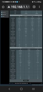

Let me know if I missed anything I'm on my phone right now so it was kinda a PITA to get it all
Imagine what it’s like to try to read it. :rolleyes:
All I can really see is that you’ve duplicated some domains in the dnsmasq.conf.add file. And DTV is in Bulk. Everything else was too messy to interpret.
hey can i set device priority under the Bandwith Monitor Tab in conjunction with qos?
