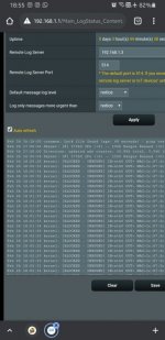

@Jack Yaz I'm running 386.1_2; conmon v2.8.4 on AC88U, and I'm not able to see 24hs charts. I have to switch them to 7 days or 30 days, if not they'll show up as empty. Any possible solution to it?
Also when exporting with non-unix, timestamp shows 12/31/1969 instead of 2020/2021
Thanks!
Thanks!
All the dates? Check if you manually run connmon does it error

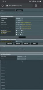

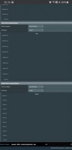

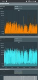

About graphs, I'm attaching screenshots even running it manually 24hs is not loading.
Abous csv file all tests have same 12/31/1969 date (screenshot attached)
