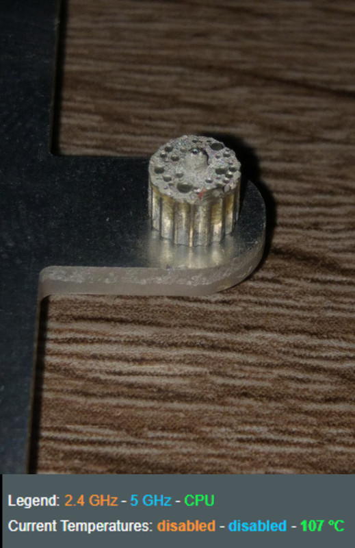

Gnuton keep pumpin em bro. my router is running a scorching 110*C, and my 5g band says 75*C idk when i should worry but this thing is a trooper and you are doing awesome. i hope someone eventually does some of the other dsl model routers. I put away my other one just to set this up on my DSL-68. I love it- despite the crazy temperatures and the site survey not working.
If you dont repair it very soon you had a router!
They should have about 75°C CPU and <60 for WLAN.
Probably chips lost contact to heatsink or its to late at all and hardware is broken.
it cools down if i disconnect some of my devices. the minimum the processor runs at is 95*c and the 5g will run at 65*C for a few hours. i have to reboot it like every other hour for performance reasons.
because running much too hot, CPU will step down -> your performance reasons.
No matter what you connect it should not go above 80 even in summer.
i thought about removing the back and putting a fan behind it, but then i wouldn't be able to cool the rest of the room. (only one fan)
we are in a tight office area and have to stay constantly connected to the internet unless we take a break. (every few hours or so)
thank you for the tip though i am in the process of bidding for another refurbished one. I will then put Gnuton merlin384.11 --- i really hope gnuton enables the DoT feature....
