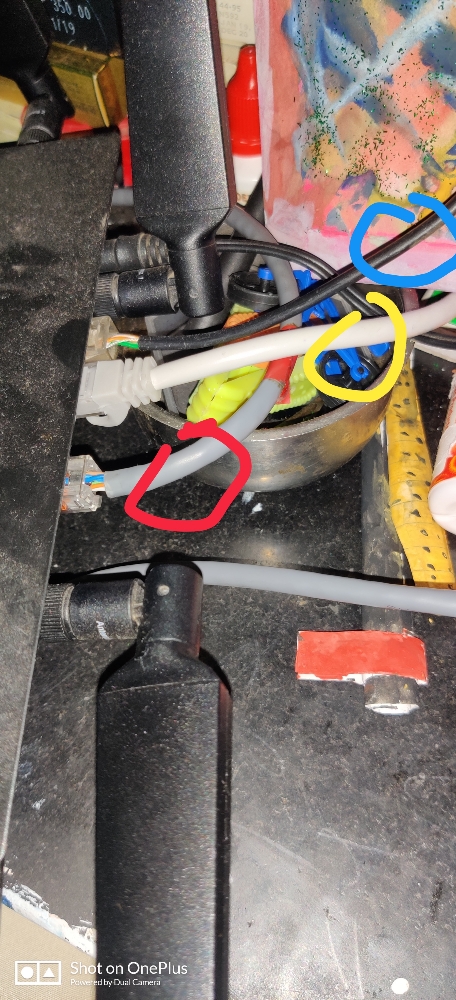

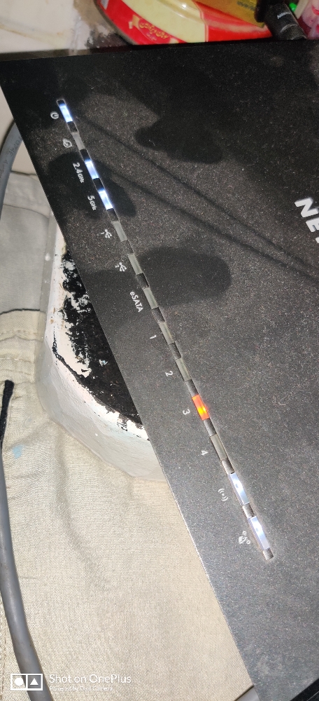

    Ok so see hear the one which i marked with red that's a different cable i m getting connected through the internet on my laptop from that cable and the one which i marked with yellow i m not getting connected its a 20M long cat 6 wire .. and on the same wire which i marked with yellow is connecting to my desktop but not on laptop and the black wire which is there is my isp wire from which i m getting internet i hope u understand so i m not able to identify what's the problem .. the resion y i m on it is the place the yellow mark wire is my work place so i need an internet connectivity there via wired connection and from the red marked one when i get connected it shows me the orange light as u can see [​IMG]
    Sent from my GM1901 using Tapatalk
    [​IMG][​IMG]

    That grey cable marked red is not a good cable. It has too much wire out from the plug. It needs to be replaced. The black cable marked blue also.
    You would be OK if you were doing 10 meg. They are bad for a 100 or a 1000 meg.
    CaptainSTX and L&LD like this.
