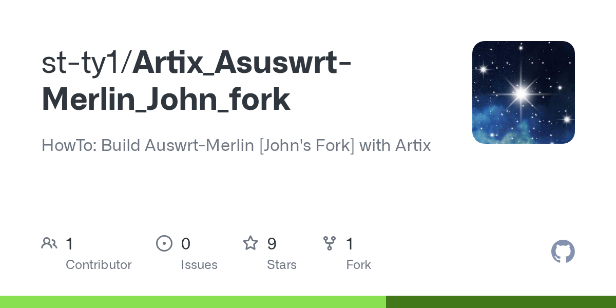

Github source: https://github.com/john9527/asuswrt-merlin (Branch 374.43_2-update)
Thanks to forum member st_ty_
