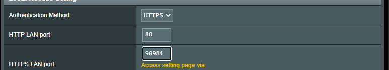

Also as i said port 80 is getting forwarded by the router when UPNP is enabled yet port 80 should be disabled when HTPPS is selected. that has not been fixed since last stable now I've had a better look. on official this don't happen.
