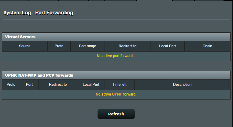

@GNUton after 8 hours it's now 153, also noticed a problem with port fwd see pictures

@GNUton The memory issule I think is down to the above port forwarding issule, 300 connections all the same and increasing, after 15 hours the memory free is now 142mb.
