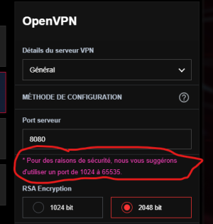

With my old RT-AX88U router and Merlin firmware, I configured my OpenVPN server on port 443 because it was the only one that was open on the public networks that I use when traveling. Now with my new GT-BE98 pro router I can no longer enter anything as a port lower than 1024.
However in the GUI configuration page, there is a message which says that Asus "suggests" to use a port higher than 1024. In this case, they should rather write "required"!! If it really is a suggestion we should still be able to choose a port lower than 1024... :mad:
Is there a way to force port 443? Perhaps by connecting via SSH we can modify a config file? 🙏
In short, I'm starting to be quite disappointed with this useless router and I may finally return it...

GT-AX6000 FW 3.0.0.6.102_21514: Please enter a value between 1024 to 65535

This is a very serious limitation. I travel a lot and sometimes VPN on port 443 is the only option. The reason I have VPN server running on this port. I’m with @Alaska99 on this one. Bad decision on Asus side. I may want to run my router with no firewall. This is my router and the decisions are mine - a Pro user with Pro router.

No, the parameters are stored in nvram. I don't remember which variable contains it on the tock firmware, and there's no guarantee the firmware will accept to use it either. Every time you edit your VPN settings, it will most likely complain about it as well.
