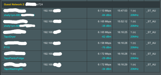

I am struggling to understand how Asus / Asus Merlin sources its name in the Wireless Log (under the System Log Tab), vs those displayed in the Network Tab "Client Status" and "View List" Tables of what is connected.
I ask as I recently added some Shelly IoT (1 PM) devices to my Guest Network 2 (intranet disabled) and:
  1. Originally, when the devices connected via DHCP I could see these in the Wireless Log as the original names Shelly gave them; then

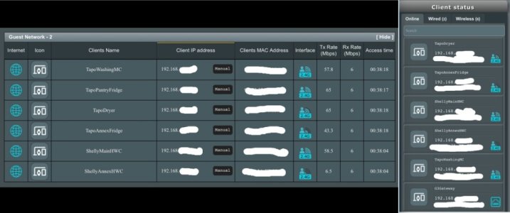

  2. When I set a DHCP Reservation I could also see them in the Wireless Log with the reserved IP and the new name I gave them (and in the Network Tab Client Tables); then

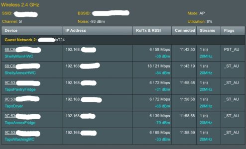

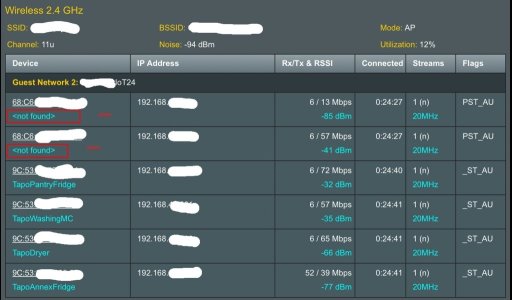

  3. When (due to connectivity issues), I was recommended to set a STATIC IP in the Devices themselves, I set these (it fixed the issues) and whilst the Network Tab "Client Status" and "View List" Tables still showed the name in the DHCP reservation, the WIRELESS Log now shows a <not found> entry; this despite the correct names being shown in the Network Tab (even after a reboot)?

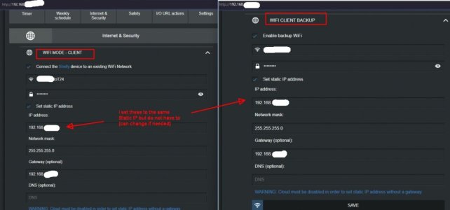

When I set a static IP in the Shelley Device Admin Pages (see pic 5), I also added a 2nd Wifi (as a backup) and I set the same Static IP Address as for the Primary Wifi (Wifi1), on the basis that if it defaulted to the 2nd Wifi (due to a poor or weak signal), then it would simply use the same Static IP (which is unique anyway) and is in any case reserved. I checked (by removing it and rebooting) if this was the issue but it does not seem to be.
When I set the Static IP in the Shelly Admn I did NOT put in a DNS; I use Cloudflare on 1.1.1.1 and 1.0.0.1, should I maybe set this in the Shelly Admin, would that help with the naming?
What I have not done (yet) is rebooting the Shelly Devices after renaming them under "Device Name" in the Shelly Admin; I am not sure whether this name is passed to e.g. the Router or just used for the Shelly Admin itself.
As an aside, my double use of the Static IP is probably not good practice (although I thought if it goes to Wifi 2, it does not matter anwyay) and happy to be advised if anyone sees an issue with this, I can just let the backup Wifi default to DHCP (or set a unique STATIC IP for the Backup Wifi and setup another (unique) DHCP Reservation for it, although I wanted to avoid doing this).
I attach screenshots to hopefully show what I mean:

I'm not following by what you're trying to say with primary and backup wifi, are you saying you have two routers each with separate DHCP servers? That's going to be a problem on your entire LAN if so. You should have one and only one router and DHCP server and if you need additional wifi coverage just add an AP to that (or setup AiMesh).
On the Wireless Log page, I extract it from the dnsmasq lease list, by matching the MAC.
For the Networkmap, Asus can extract it from various sources, be it NETBIOS or DNS. The details of which methods they use are closed source.

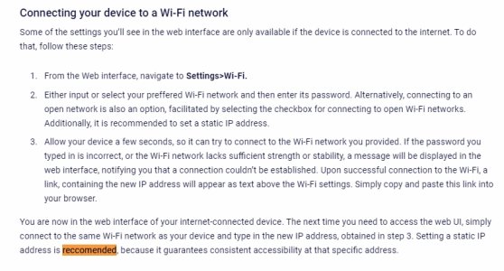

  1. Shelly themselves recommend it - https://kb.shelly.cloud/knowledge-base/shelly-plus-1pm-web-interface-guide

  1. Shelly themselves recomend it - https://kb.shelly.cloud/knowledge-base/shelly-plus-1pm-web-interface-guide

Then if you want them to show up by hostname in the Asus, you're going to need to do a dnsmasq.conf.add or dnsmasq.postconf script to add their hostnames to DNS.
However any device that isn't able to do DHCP reliably has major problems.
The vast majority of pages throughout the Asus will use DNS name (which is either what the client has reported when it obtains an IP, or the hostname you assigned when you created a DHCP reservation for it). When neither of those exists, you'll either see a generic vendor name, or "not found" or similar. So if you've set a static IP on something, you're going to see "not found" most likely.
This is the terminology in picture #5, from Shelly Admin page. I assume they allow you to provide two Wifi SSIDs, so I have my 2.4GHz IoT Guest 2 as Wifi1 one and my Private main Wifi (non-guest ) as Wifi2. Hope that explains it ok.
OK, so somehow as drinkingbird said, I need to find a way to get it into the dnsmasq lease list manually; although oddly, WITHOUT the Static IP, it was correct and the same as the Network Map names, which I assume followed what I put into the DHCP List.

Because that hostname you've specified only gets put into DNS when the device requests a lease. If you have a static IP, your device never request a lease, and that DHCP reservation is not "active". You can confirm this by looking at the DHCP leases screen. If it isn't there, it isn't in DNS.

Two different SSIDs on the same router is not providing you any sort of redundancy anyway, if the router or radio fails, both will go down.

Those are scripts run on the router to manually add hosts into DNS. The shelly devices not working right with DHCP is in reference to those devices, but I suspect it is more related to the dual SSID stuff and not DHCP itself.
OK, so somehow as drinkingbird said, I need to find a way to get it into the dnsmasq lease list manually; although oddly, WITHOUT the Static IP, it was correct and the same as the Network Map names, which I assume follwoed what I put into the DHCP List.
From my observation if you have set a name in client list manually, that will also show up in the wireless log screen. Another explanation is until your lease expires or is released (or you reboot the router), the hostname will remain in DNS, so you may have been looking after you changed to static but before you rebooted.
So if you want to see the correct names in client list and wireless log page, just set a manual name in the client list. That will not update DNS so some stuff still won't show a host name, but those two screens should.

At that point there is no reason DHCP reservations should not work and you can set the Shelly devices to DHCP. But if for some reason you need static, go into client list and overwrite whatever is in there with a manually entered name. Even if it is the same name I think it will add it to the manual client list and thus populate your wireless log as well. But you may have to make it a slightly different name (even a capital letter in place of a lowercase should do it).
May take a minute or even a reboot for wireless log to update with the client name. But if you can get DHCP working with reservations, that's the best and cleanest solution.
I suspect Shelly recommends static just so the IP doesn't ever change, and DHCP reservation accomplishes that and also lets you set a hostname to put into DNS and all the various screens in the router automatically.
Actually wireless log must look at the custom name NVRAM variable too as my blu ray player shows up as the name I gave it in client list and not blank (hostname in DHCP leases) or "Hon Hai" which is the default it shows in client list.
It doesn't. I wrote that code, and I never interfaced it with networkmap.
EDIT: I think I see where it might be coming from. I have the webui display any existing device nickname (which is defined by either Networkmap or the enduser) whenever the hostname is returned as <unknown>. This is done within the webpage itself rather than at the backend.
                        hostname = client[2];   // Name
                        if (nmapentry && (hostname == "*" || hostname == "<unknown>")) {
                                if (clientList[mac].nickName != "")
                                        hostname = clientList[mac].nickName;
                                else if (clientList[mac].name != "")
                                        hostname = clientList[mac].name;
This is only if there is no matching entry in the dnsmasq lease list.
