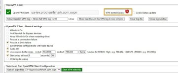

Hi, I've installed Kamoj Addon 5.5 Beta on my R7800 - V1.0.2.92SF (2022-02-18) (Voxel). Kamoj Add-on:220305-194131-5.5b20. Aegis:1.7.12.
Also I managed to configured config files for OpenVPN and Wireguard. After running corresponding client there is no errors in log, but VPN doesn't work - status is red and I cannot connect to any external host. What could be the reason?
Regards, Vasiliy
Regards, Vasiliy
I'm away from keyboard and have limited I internet access, so
Cant help much now, but,
Please try and check the boxes for:
Status cyclic update.
Restart at connection failure.
Also switch on extened in supervision menu+check traceroute setting, and look at supervision log. Please attach dump of router information as well.
It might help you to switch on use of Dnscrypt.
I suggest you try openvpn first since it har more checks and extended reporting to identify issues.
Stay safe!

Do you have both OpenVPN and Wireguard enabled at the same time? Because I don't think that is supported.
also, how did you conclude that you cannot connect to external hosts?
did you only try connecting via DNS name? or did you also try connecting via IP-address.
(for instance ping 8.8.8.8)
Potential cause: the DNS servers from your ISP provider are only accessible via their connection.
The moment you enable VPN, traffic to those DNS servers would be routed via VPN and thus no longer work.
So it appears the connection is down, because you can no longer browse via DNS names.
If so, then solutions are:
manually configure different DNS servers.
Or start using DNSCrypt (this also use different DNS servers).
Or in the VPN bypassing settings, enable "Router it-self bypass VPN" (this way the router will connect to internet directly and thus the ISP DNS servers would be reachable again.
