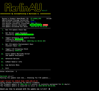

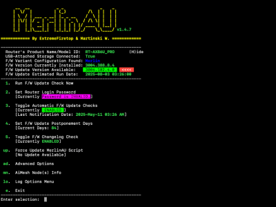

Thanks for the quick reply.
So, here is what I see when I meant MerlinAU reports Password is INVALID:

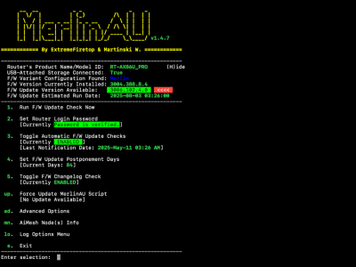

I can choose Option 2. and set the password again (using exactly the same credentials), and it works, so that this is what I will then (temporarily) see:
However, if MerlinAU then runs an FW check, whether manual or automatic, it attempts to login to my AP (which yes, as you say, is not running Merlin anyway, and so it shouldn't be trying to do this):
MerlinAU then goes back to reporting the password is INVALID, even though it is not invalid for the main router.

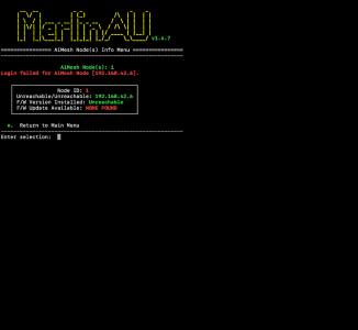

I don't know why MerlinAU is seeing the AP as an AiMesh Node when it is not an AiMesh Node.
If I select option mn. this is what I see:
