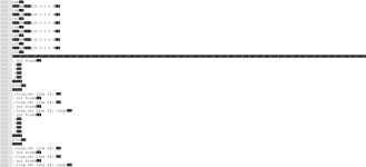

The log is different now.
148
^[[H^[[J0 0 0 0 0
149
^[[H^[[J0 0 0 0 0
150
^[[H^[[J0 0 0 0 0
151
0^M 0^M 0^M 0^M
2753^M
./loop.sh: line 24: ^M: not found
./loop.sh: line 24: clear^M: not found
0^M 0^M 0^M 0^M
2754^M
0^M 0^M 0^M 0^M
2755^M
2898^M
0^M 0^M 0^M 0^M
2899^M
0^M 0^M 0^M 0^M
2900^M
0^M 0^M 0^M 0^M
2901^M
The change starts from iteration 150-151 and then goes on for some time with "^M: not found" messages until it freezes at 2901.

See all the special characters from the log in the attachment.
I wonder why your 86U produces these weird results in the log, yet mine doesn't? Could there be a slight variation in the hardware somewhere?
I got a couple of other ideas that haven't been explored but I am coming up short from my cellphone at the job.
You certainly earned the gold star of the day for coming up with creative troubleshooting solutions!! :cool:
I cannot quite explain how my log ended up like this but it must have something to do with my Windows machine.
I mean - look at the carriage return symbols. I think I have spoiled the script with an accidental CR character. Possibly the 2 parts of the log are concatenated from 2 different runs and one of them is a broken script.
