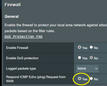

I enabled firewall and for outside i can't do traceroute if i disable firewall is back to resolve.
For what i search ICMP need to allow and respond ping but even enabled Respond ICMP Echo still i can't resolve traceroute issue.
- How i can enable traceroute with firewall enabled.
- How i can enable traceroute with/without Respond ICMP Echo enabled.

Enable the option in the router's firewall.
Try it with DoS protection disabled.

As i say in my post, i have enable or disabled Respond ICMP Echo.
Also no matter what OS i using because if disable firewall works fine.

In your output with the firewall enabled it looks like the option "Respond ICMP Echo (ping) Request from WAN" is still set to "No". If that's not the case then it looks like a GUI bug of some sort.
Are you actually testing this from the internet or are you trying to do from your router via a VPN?
Try turning off WireGuard and seeing if that makes a difference.
Yes, previous iptables is with ICMP Echo disabled.
Here with enabled.

I don't use any VPN, i testing this from internet.
Yes the ping works (always work) only traceroute no.

Just delete rule #2 and you can traceroute again. Strange error in 386.11.
iptables -D INPUT 2
Or you can duplicate rule 11 (icmp) making it first rule:
 iptables -I INPUT -p icmp -j ACCEPT
