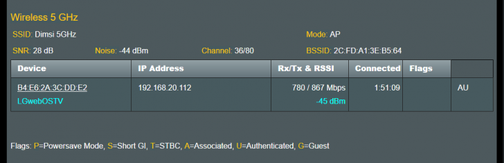

Anyone have this? A extra case appeared and "Flags" is in the wrong one
