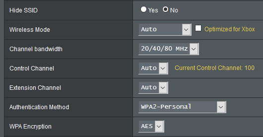

If it's there, it's on the Wireless > General tab, in the Control Channel section (visible when set to Auto):
(EU version)
thanks, interesting, on my stock 86U set to region EU it even uses ch. 100 but no enable box for it.
