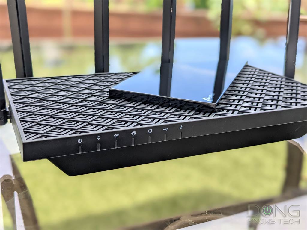

Something is off. This router is popular and with very good feedback. I see V1 with V2 only from Canada and V2 is a new device on initial firmware.
This V1 router is the same hardware like the many Asus RT-AX3000 variations, but with unlocked 4x4 5GHz radio like in AX5400-class RT-AX82U, etc.

Well my cams went offline again. TP-LINK Tether can't see the router on 2.4 but OK on 5ghz. Something is wrong internally.
Last straw was getting a tech support guy from TP-LINK who couldn't speak english and wanted to virtually start over on the "troubleshooting". I finally got frustrated and said this isn't worth my time. router goes back to Amazon. Bye. 5 minutes later a supervisor calls and says we're going to escalate this to next level. OK I ask, when will they get back to me? Between 24 and 48 hours. Uh no. I've already wasted enough time proving the product doesn't work. Back it goes to Amazon.
I may be a glutton for punishment but I'm gonna try the same router as a replacement from Amazon. I have to think that the 2.4 devices losing their connection is a hardware problem (defect). So we'll give it one more shot and see.
