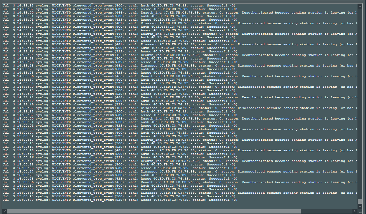

Hi everyone,
I am currently having WiFi connection issues. At random times, the internet gets cut off and I have no connection for about 30 seconds. Sometimes it can dropout 3 times in 30minutes, and sometimes it can go 10 hours without no dropout and then suddenly dropout.
I have connected my device through ethernet cable and it seems I went 3 days straight with no dropouts. When I connect back through WiFi, it will dropout randomly again.
After looking through the system log, I can see these 4-5 same lines that repeat over several hours :
This repeats constantly. The MAC address associated to that address is the node router.
Is this the cause of my WiFi dropout connections? How can I fix this issue?
Perhaps the signal strength between the router and the node isn't strong enough to maintain a stable connection. Move the node much closer to the router and see if the messages disappear.
OzarkEdge
Part of the Furniture
What RSSI and Tx/Rx values do you see in the Wireless Log for the node's wireless backhauls/MACs? Use these to judge the strength of your wireless backhauls for given distance, path, router WiFi settings, and ambient signal interference.
