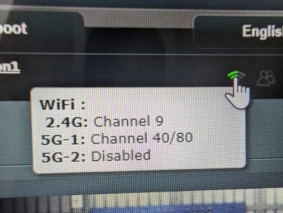

I have 3 routers in a mesh system all connected back to the master router by LAN.
2.4 and 5-1 are working but I have a half wireless icon which when I click on it says 5-2 is disconnected.
Is this due to the LAN backhaul or should it be operating as well?

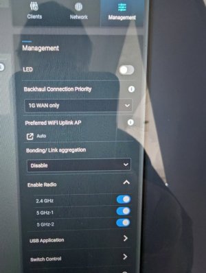

depends, what router do you have as the primary? Latest versions for AX92U allow having all three bands broadcasted even when the AX92U is a node unless a dual band router is the primary router.
What does it show under Enable Radio on the management tab on the AiMesh page when you select the AX92U node?
This is what mine looks like for comparison.
Also, should have asked earlier but does your primary router also broadcast the 5-2 band or only 2.4 and 5-1?

This is the strange half icon.
It seems 2.4 and 5-1 are ok but 5-2 disabled!
All 3 of my AIMesh nodes show this.
The backhaul is set to LAN

Ah okay, can you go to Wireless settings and then under the Professional tab, is Enable Radio set to Yes for 5 GHz-2?
