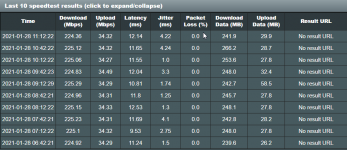

Hi!
Yesterday afternoon, wednesday January 27, I received my new Thomson/Technicolor TC4400 modem,
I installed it and give it a try.
Here are the results: No more packet loss :)
A graph is worth a thousand words. Isn't it ?
Now, should I care about Latency/Jitter values ?
Thanks for your help, you are the greatest... ;)
ItiBi

The Latency/Jitter values seem normal to me for a modem connected ISP service.
I'm sure you may be able to get some slight improvements from your ISP, which will not be noticeable, but nothing like the upgrade you got by swapping the modems though. :)
I would leave this as-is. Thanks for the report!
