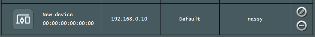

You can do this by creating a manual DHCP reservation at LAN - DHCP Server > Manually Assigned IP...
Even if the host isn't a DHCP client you can use the option above to create a DNS entry for the host name. You don't even need to specify the actual MAC address (although it's advisable), you could use 00:00:00:00:00:00.
I feel a bit silly not trying this first but it was exactly what I needed to do.
I checked the hosts file and its persistent across reboots, the only difference is it added a fullstop to the end of the hostname
manually adding This with a fullstop will still be wiped, but doesn't matter as now I understand it can be done through the GUI.
Appreciate the help for solving my issue!
