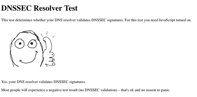

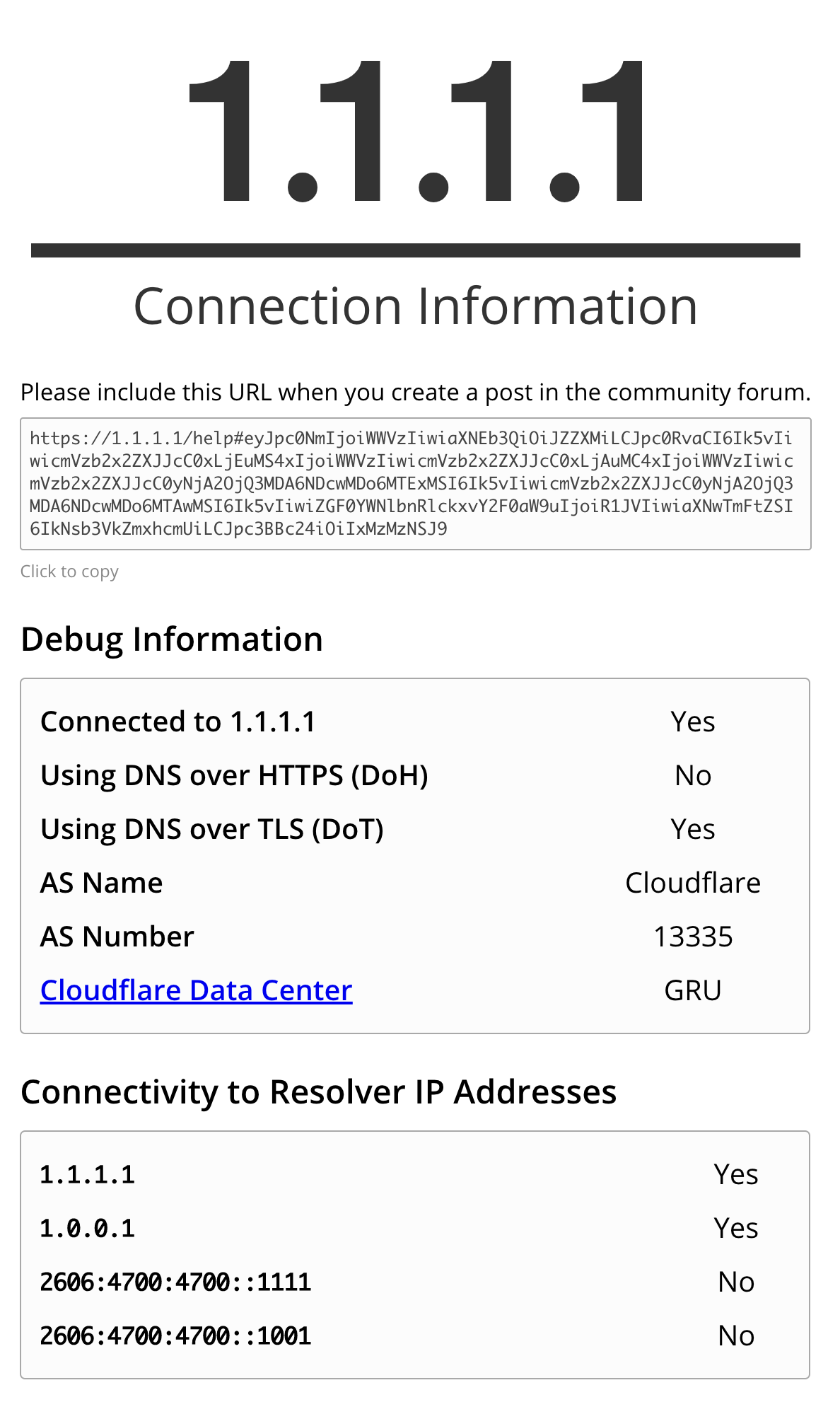

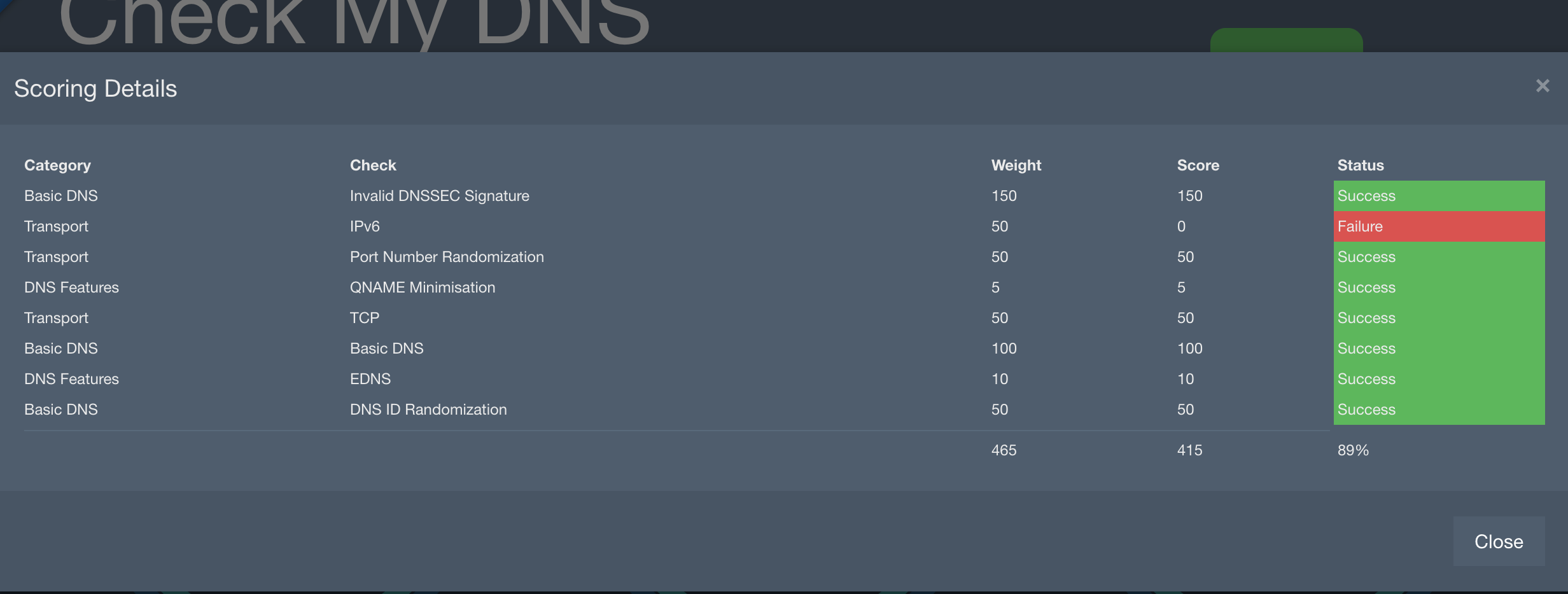

My best results with Stubby are with CF resolvers and roundrobin = 1. Am on 10 meg DSL IPV4 only.

This was my best setup at Stubby:
tls_ca_file: "/rom/cacert.pem"
resolution_type: GETDNS_RESOLUTION_STUB
dns_transport_list:
  - GETDNS_TRANSPORT_TLS
tls_authentication: GETDNS_AUTHENTICATION_REQUIRED
tls_query_padding_blocksize: 256
edns_client_subnet_private : 1
idle_timeout: 60000
round_robin_upstreams: 1
appdata_dir: "/opt/var/cache/stubby"
listen_addresses:
  - 127.0.0.1@5453
  - 0::1@5453
upstream_recursive_servers:
# IPv4 addresses
# Cloudflare
  - address_data: 1.1.1.1
    tls_auth_name: "cloudflare-dns.com"
  - address_data: 1.0.0.1
# IPv6 addresses
# Cloudflare
  - address_data: 2606:4700:4700::1111
  - address_data: 2606:4700:4700::1001
Wan DNS1: 127.0.0.1
Wan DNS2: 0.0.0.0
Dnsmasq:
strict-order
Tests:
Option on Stubby.yml -> round_robin_upstreams: 1

What are the three graphs supposed to show? I only see three broken icons..
