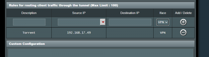

step 2:
OpenVPN Client - set "Start with WAN" to "Yes"
OpenVPN Client - Redirect Internet traffic - Policy rules
Rules for routing client traffic through the tunnel
add IP 192.168.1.10 to the list
I know this is a very old thread, but maybe somebody still looking into it. On the step 2 listed here you have to add the Transmission client IP address as defined in the settings.json file. I did it as follows:
Is that what is needed? Should I chose VPN or WAN as the interface? Just leave the rest blank?
The setup is not working for me so far hence the question! Thanks!
Yes, that is what is needed in step 2.
Do you already have a working setup for VPN client so you know that your VPN client works?
Did you follow the other steps?
Also, change step 1 with the following by Jack Yaz.
It you insert your credentials on web ui VPN client it's not enough for transmission?
I guess you mean routing all traffic through VPN and in that case I believe it should be enough. The point here is to make only transmission traffic go through it and have all other router clients use the wan.
