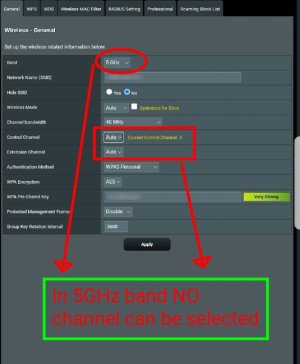

Hello, take my warm greetings and I hope you are doing well. If you have knowledge or ever faced this following issue then I really need your kind support. First, let me inform you the issue I am currently facing:
My Router Model: ASUS RT-AC66U B1
Firmware version : 3.0.0.4.386.51255 (Recently I updated to this newly released firmware and after a few days the following problem occurred)
At night time everything was alright but after I woke up in the morning found that the SSID of 5GHz WLAN is not working and also the blue LED indicator of 5GHz WLAN is also OFF. So, I did the following (one step at a time) but the same issue remained:
1) Restarted the router
2) Turned OFF both 2.4GHz & 5GHz WLAN and restarted them
3) Reset to Factory Defaults
4) Downgrade the firmware to the previous version of ASUSWRT (3.0.0.4.386.49703)
5) Changed the firmware to ASUSWRT-Merlin (RT-AC68U_386.10_0)
But the same issue remained and later I found that the MAC address which was previously for 5GHz WLAN, currently appears in 2.4GHz WLAN and NO MAC address appears for 5GHz WLAN. Also all the channels of 5GHz band appears in the user interface of 2.4GHz band and NO channel appears in the UI of 5GHz band: The 2.4GHz band showing the channel of 5GHz band (e.g. from 36 to 165) which should not be the case and also 5GHz band showing 0 channel and not broadcasting any signal (Please see the three attached screenshots for more details).
I hope you now understand the problem. Please feel free to let me know if you require any information. Thank you for your kind support and time. Take care and be happy always!

After the router got rebooted the same issue remained as before: MAC address which was previously for 5GHz WLAN, currently appears in 2.4GHz WLAN and NO MAC address appears for 5GHz WLAN. Also all the channels of 5GHz band appears in the user interface of 2.4GHz band and NO channel appears in the UI of 5GHz band: The 2.4GHz band showing the channel of 5GHz band (e.g. from 36 to 165) which should not be the case and also 5GHz band showing 0 channel and not broadcasting any signal.
So could you please provide any insight? Is it possible to manually change WLAN MAC address for both 2.4GHz & 5GHz by using PuTTY with SSH connection? Please let me know your thoughts with necessary procedures. Thank you once again for your kind support. Take care and have a nice day!

Thank you once again for your nice reply. Yes, it is a genuine ASUS RT-AC66U B1 router and I used this router only for 3 years. The problem here is that the scenario of 5GHz band (e.g. channels from 36 to 165) is performing under the name of 2GHz band and those channels of 2GHz band (e.g. channels from 1 to 11) are completely disappeared. As I mentioned in my previous message that the MAC address of 5GHz band is appearing under the name of 2GHz band and that's why probably this namely 2GHz band is performing the works of 5GHz band. So the missing here is the original MAC address of 2GHz band and its related channels (e.g. channels from 1 to 11).
You might be right that I need to replace the router but I want to dive deeper to find out the issues as I used this router only for 3 years. Thank you for your invaluable time and kind support. Take care and have a wonderful moment always!
This is what happens when your 2.4GHz radio is not working any more. The GUI gets confused because it's not expecting this and puts the 5GHz settings in the 2.4GHz tab. Bottom line: It's broken.

@RMerlin: Thank you for your nice message. For a couple times I have performed your suggested "Electrical Reset" but the issue remained as before. Let me explain once again so that you might relate this issue with other solutions if possible: The problem here is that the scenario of 5GHz band (e.g. channels from 36 to 165) is performing under the name of 2GHz band and those channels of 2GHz band (e.g. channels from 1 to 11) are completely disappeared. As I mentioned in my previous message that the MAC address of 5GHz band is appearing under the name of 2GHz band and that's why probably this namely 2GHz band is performing the works of 5GHz band. So the missing here is the original MAC address of 2GHz band and its related channels (e.g. channels from 1 to 11).
You might be right that it is hardware failure but I want to dive deeper to find out the issues as I used this router only for 3 years. Thank you for your invaluable time and kind support. Take care and have a nice day!
Thank you so much @ColinTaylor for your valuable insight. Your explanation sounds very logical. Is there any way to fix this 2.4GHz band? Do you have any idea? Please share. Thank you.
