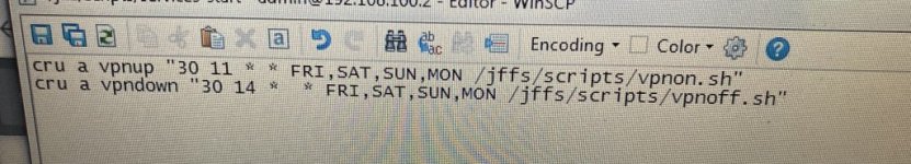

Yep... Add these statements to your 'services-start':
cru a vpnup "30 10 * * FRI,SAT,SUN,MON /jffs/scripts/vpnon.sh"
cru a vpndown "30 14 * * FRI,SAT,SUN,MON /jffs/scripts/vpnoff.sh"

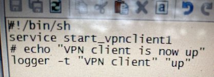

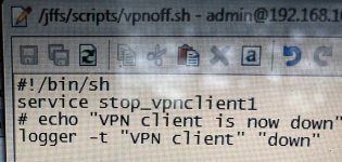

And, like how Fr3d explained near his OP, create 2 files under your /jffs/scripts:
vpnon.sh contains the commands to start the vpn service at 10:30 and write to syslog.
#!/bin/sh
service start_vpnclient1
# echo "VPN client is now up"
logger -t VPN client "up"
vpnoff.sh contains the commands to stop the service at 14:30
#!/bin/sh
service stop_vpnclient1
# echo "VPN client is now down"
logger -t VPN client "down"
FYI: The OP's use of quotes in his logger statement makes no sense.
I can't guess what his intention was but it should either have been:
logger -t "VPN client" "up"
or
logger -t "VPN" "client up"

OK. I created the services-start. I added the cru to services-start but it does start automatically regardless of the time/day.
How can this be fixed?
I also have added the syslog scripts to jffs/scripts folder.
Thanks!

This is the screenshot. (Don’t mind the hours. I was trying to make it work by changing the time). This is the only cru I have. Nothing else.
What happens is; after adding this cru at services-start, the VPN automatically starts when I reboot the router. I have to manually stop the client. Otherwise, it will not stop by itself even at “scheduled” cru.
If that's your "services-start" file, make sure you have a she-bang at the top...
#!/bin/sh
Are you sure your VPN client isn't starting by itself after you reboot your router because you have enabled "Automatic start at boot time"?

OK... so your "services-start" file should contain this... does it look right on your end? I made a small modification... make sure you add "sh" in front of the "/jffs/scripts/..."
#!/bin/sh
cru a vpnup "30 10 * * FRI,SAT,SUN,MON sh /jffs/scripts/vpnon.sh"
cru a vpndown "30 14 * * FRI,SAT,SUN,MON sh /jffs/scripts/vpnoff.sh"
Then, reboot your router... and these cru commands should automatically add themselves to your cru tasks. So when you run "cru l", you should see something like this:

Try adding them manually... do you see anything in your cru task list (cru l) after you type this command?
Yes, when I do cru l, I get this: 30 10 * * FRI,SAT,SUN,MON sh /jffs/scripts/vpnon.sh #vpnup
AFTER adding the command.
I also
see the off version after adding this command, cru a vpndown "30 14 * * FRI,SAT,SUN,MON sh /jffs/scripts/vpnoff.sh"
