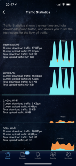

I do have 18 devices in the DHCP reservation list and the AX86U is on firmware 3.0.0.4.386_42095.
I don't know if anything was actively downloading, but we do have 50+ devices on our network. Maybe a third of them are IoT devices. The rest are TVs, computers, tablets and smartphones.
We've been noticing though that wired speeds have been slow for some of our Smart TVs. Apps. will crash or black out and show that the connection is too slow. We'll notice slow connections on our phones and tablets as well whether they're connected to the AX86U's wifi signal or the Ubiquiti's wifi signal. This has started fairly recently and I did update the AX86U's firmware fairly recently as well so I was thinking it might be related to that.
When running the speed test in the Asus app. it shows that speeds are what we expect them to be (~830Mbps down and ~200Mbps up).

Can you please provide more quantitative speed measures? "Slow" really doesn't give one a sense of how much slower than 830/200 that you say is what you expect. For example, wifi is always slower than wired devices. And some wired devices just don't support 830Mbps download speed. Phones, tablets, and smart TV's can fall into that, depending on how old they are and what their wifi hardware is. Not getting a sense of what you're seeing...the snapshots you provided are interesting, but those look like instantaneous snapshots, and really don't say much about average speed, or speed when there's actually something going on. Or have a time scale on them.
