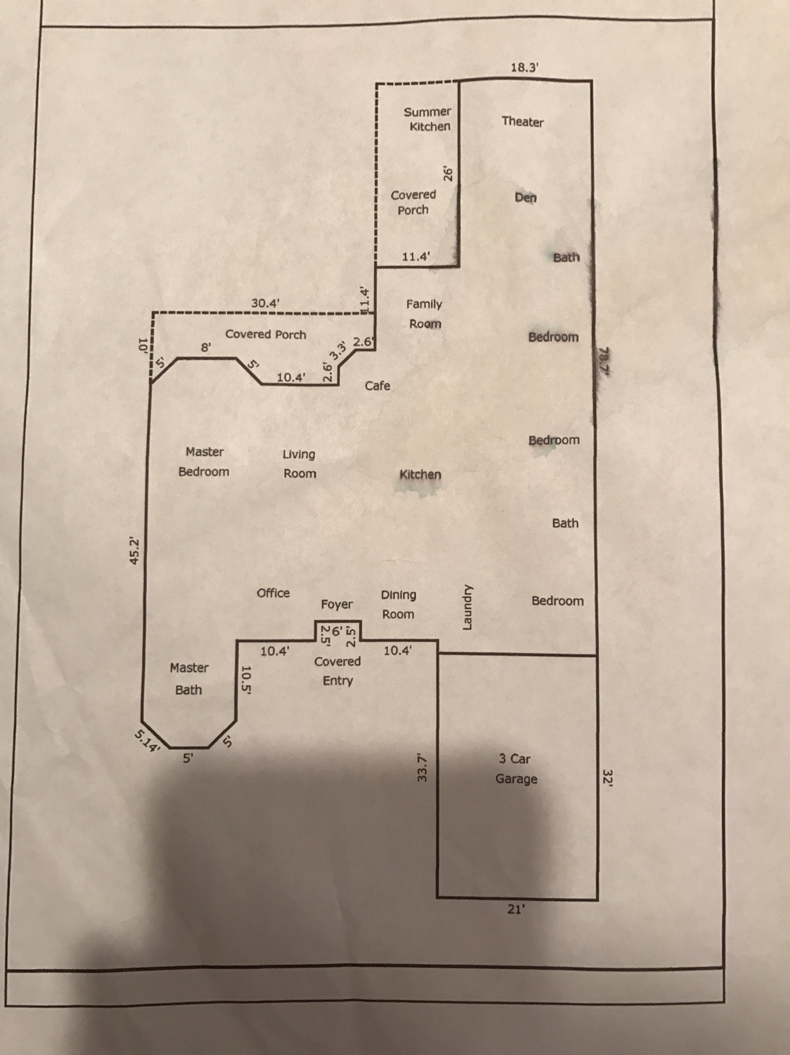

I have a 3000sq ft house I am looking for a WiFi router that would work the best with no dead spots including the back yard. There’s going to be multiple mobile devices, one laptop, 3 fire sticks, also the house is one story...
i would put an Ac wireless router or AP on the word "cafe". The 5ghz bad should cover most of the center area and maybe out into the bedrooms. The 2.4 ghz band should cover all of the area unless there are too many partition walls or brick exterior wall. Place it on the ceiling. Get a POE model and run an Cat 5e or 6 ethernet cable from the ISP router through your attic. You will need a POE injector at the ISP router. If you are streaming a lot, you may want to connect TVs and such via ethernet cables rather than wireless to avoid bandwidth issues when multiple devices are online.
Get a four-stream (AC2600/AC3150) class router, such as the NETGEAR R7800.
Place it as centrally as possible, as degrub suggested. As he also said, it might not reach outside or all locations depending on home construction.
