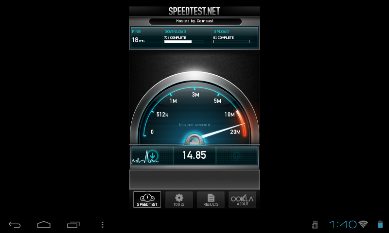

Ran G54 802.11g 20HT on tablet running Android Ice Cream 4 32-bit single core 1.1GHz OC 1008MHz 1GB DDR3 and got burst range 22mbps then 14.85mbps download from WAN to LAN. This is only available with my Power 54 G+ Code.
Results are mixed as you can see using Mix mode on master AP.
