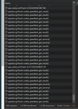

Upgraded the GT-AX6000 Router today. Mostly everything good except for the observations already made in this thread:
- Let's Encrypt cert seems to be taking some time to re-authorize
- Speed Test is broken
Other than that - everything else is OK.

EDIT 4: Regarding the Speed Test issues - when the test is triggered, it's just a constant stream of appGet.cgi calls.... they all have a 200 response but eventually fails.
