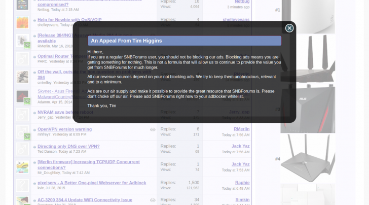

@thelonelycoder Just happened in the last couple minutes. Every time snbforums page loads this message displays:
@thelonelycoder I don't know how your ad-blocking works ('cos I don't use it) but you might need to whitelist these and possibly others:
aax-us-east.amazon-adsystem.com
ws-na.amazon-adsystem.com
