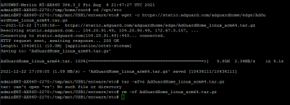

Hi thanks for the reply, i started fresh again hand have 64bit Entware then i ran your first code
cd /opt/etc
wget -c https://static.adguard.com/adguardhome/edge/AdGuardHome_linux_arm64.tar.gz
tar xfvz AdGuardHome_linux_arm64.tar.gz
rm -rf AdGuardHome_linux_arm64.tar.gz
cd AdGuardHome
this was the result

Fixed. Missing a dash in the tar command. Now redo those steps but put a dash infront of the -xfvz in the tar command or just recopy and paste the commands from the post; I have added the appropriate dash mark.

were you having this same issue? if so, that explains why you couldn't get anything to work. the tar command needed a dash in the instructions provided by the post. If you want to retry, you might be able to get it to work.
Hi before i start what is meant by "Save it and make it executable" further down in the script
tried the start with the - added, but still shows tar: can't open
Something has to be wrong with it downloading the tar file then, otherwise I cannot troubleshoot why your router is not able to perform normal tar commands from ssh terminal. I am unable to replicate the same issue on my router.
Try this: "tar -xvzf AdGuardHome_linux_arm64.tar.gz"
Hi @SomeWhereOverTheRainBow What do you think about this question?
Yes that worked many thanks stuck deciding on the AdGuard
