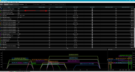

Here's the environment... this was taken directly behind the wall with the AP, outside... the camera connect to pinehurst-AP-D which has a strong ~45db signal. I used to do 20mhz but now have the router on Auto (which I guess is 40mhz at present.) Issue seems to persist regardless of 20 vs 40.

Just sounds like the N router is about to die. Replace it with an actual AP and things should be better and also give you some 5ghz in that area. Plus gigabit speeds.

As @Tech Junky said it is likely your radio is just finally burning out. However I would try hardcoding back to 20mhz channel and see if that helps. 40mhz is guaranteed interference. Signal strength means nothing if there is a bunch of noise mixed in. Doubt those cameras support 40 anyway so it is not adding benefit, only disadvantage.
But likely just time for a replacement.
