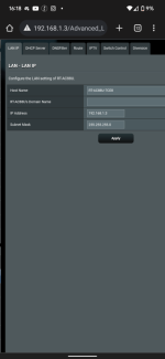

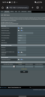

This is a great start for anyone new, I was contemplating creating a thread because I couldn't seem to find anything that started from scratch. With that said, can I check something. I have the Asus AC88U and while installing Diversion I got to the step where it asks you to modify the IP Pool start and end address and the AC88U has 192.168.50.x address, nonetheless I kept the 50 and changed the end of the IP to 2 and end on 3. However, on the next step 192.168.50.2 wasn't a reserved address. I then quickly found another thread where somebody mentioned the LAN IP address, so I changed that to from the 192.168.50.x to 192.168.1.3, then I changed the start and end pool to diversions example but again it said 192.168.1.2 isn't reserved, however, 192.168.1.1 was fine. Everything seems okay, my new router address is now 192.168.1.3 but I just wanted to check as this didn't appear to follow diversions example.

Try the following instead.
Put the router's LAN IP, IP address at 192.168.1.254.
Put the LAN DHCP Server's scope to:
Starting Address: 192.168.1.51
Ending Address: 192.168.1. 150
The above will put your router's address to 192.168.1.254.
All the DHCP clients that attach will be given an address between 192.168.1.51 to 192.168.1.150. So, for 100 client devices.
You will be able to use 192.168.1.1 to 192.168.1.50 for Diversion. (And also the range 192.168.1.151 to 192.168.1.253 too).

Wrong.
1. On the LAN - LAN IP page set the IP Address back to 192.168.50.1
2. On the LAN - DHCP Server page set the IP Pool Starting Address to 192.168.50.3, just as it says in the description.
3. In Diversion go to ep, 5 and change the pixelserv-tls IP to 192.168.50.2

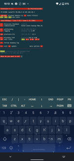

I'll do that now, can I ask however. Being's as the settings above look exactly the same as it originally was, why would it work this time? Also, by changing 50 to 1 so my IP's are 192.168.1.x what affect has this had on the network, everything "appears" to be working okay including the YouTube ad blocking which was nice to witness :)
You had originally put the DHCP Starting and Ending addresses as .2 and .3. No other devices could join (via DHCP). And you used the .3 as the router's address. Which left the .2 as the device you used to configure the router with. And, no other addresses are available (via DHCP) at that point. :)
I literally figured that out as I was setting it back up again, I wasn't entirely sure what it meant by having a start and end pool of 2 and 3 but you confirmed what I guessed because I was daydreaming after your reply and my sons oculus quest wouldn't get an ip address but connected straight away when I changed dhcp to static. Last but not least I hope, but was there any dominos affects of changing 50 to 1?
