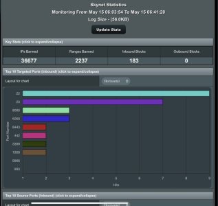

My instance of Skynet looks to be filtering incoming traffic and I am in a triple NAT setup.
My AX86U Pro is in a DMZ on the ER605, which is in a DMZ on the ISP cable modem.
Skynet logs clearly show blocked incoming traffic.

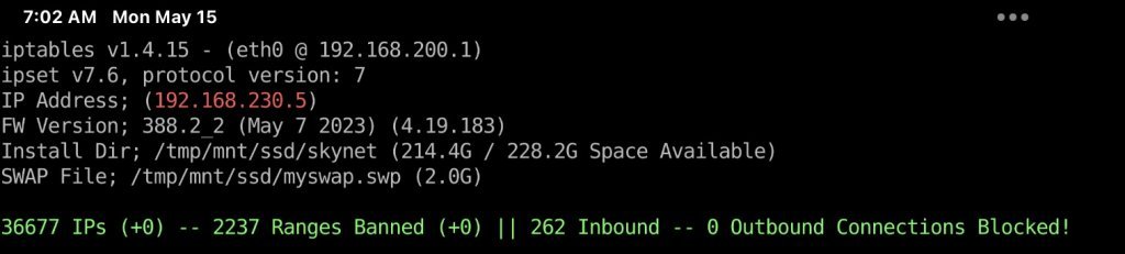

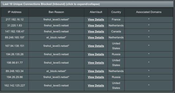

However, it shows skynets blocklists are not being used on incoming blocks. That is the picture I am painting. If you look at the other tables on skynets statistics of incoming traffic, look at the ban reason.
You can see which lists were used to determine the block. If it is a star, that means it was blocked by the firewall in general.
Here is my listing
More info….
Yes, but skynet logs all blocked incoming traffic. If there is no skynet blocklists associated with the blocks, then that is just the default firewall blocking those packets.
Skynet only logs what’s in its blocklists.
If it’s an asterisk only, it likely means the IP range being blocked was using a larger CIDR than the 3 octets Skynet checks for in case an exact match is not found. Look at line 1000 in the code.
That's interesting, I wonder if @Adamm can explain why he says inbound traffic is not filtered by skynet if wanip is private when clearly it is.
