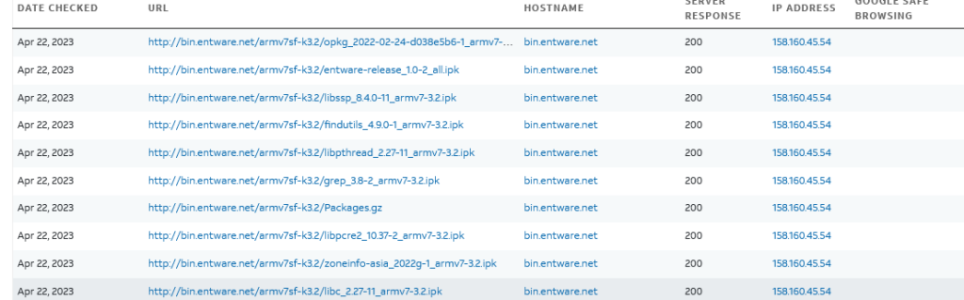

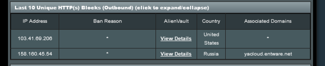

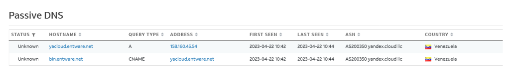

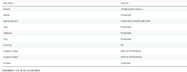

Here is some information from Skynet on my AX86S which is in front of the AP where I had problems installing Entware. It blocked this site. I'm not sure what it all means but it might be a clue to why some people are having difficulties.
That is funny, because here is where skynet whitelists it.
Maybe you have a blocked IP range that blocks yacloud.entware.net
You would think skynets default whitelisting would take higher priority over the blacklisting.
