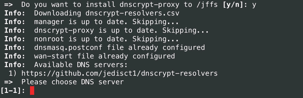

Hello!
Why does not the list of available DNSs now appear?
I only have one option available!
I assumed the system is smart enough to handle graceful rebooting with a swap file, I can't say I've looked into it in detail all that much. Will read up on it this week.
I also see no problem whatsoever with the swap file not un-mounting cleanly when pulling the plug.
Coincidentally, this only happens when I test a USB 3 device of a questionable build on one of my routers. But it will wreak a lot more than just the swap file.
Hello!
Ask the maintainer of that script, I only do the install/start menu in amtm, not a single bit of code is touched in the dnscrypt-installer script by me or amtm.
