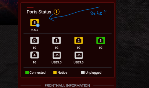

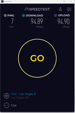

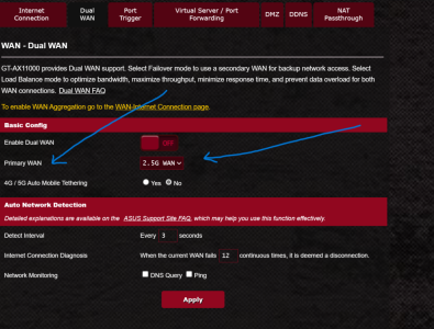

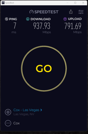

I have an Asus gt ax11000 I have noticed my connection dropped from 1000mb to 100mb after 24hrs for the last 3 weeks. I have to reset the modem from cox and also the ax11000 then back 1000mb after resetting, and also switch around the modem ports, still doing the same thing. Maybe the firmware. I also used and tried the other port,1000mb as primary, still the same. I signed up for 1blast on cox 940up/down so the fastest way to know if my connection is to check the speed test. Only getting 100mb speed means the port is 100mb speed.
help me. View attachment 55557

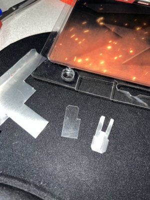

I got a simple fix on mine by shimming. Not all ports are made the same; some are oversize. Have a look at or check out my posts lately.

Heres the link!!! Simple DIY fixes
