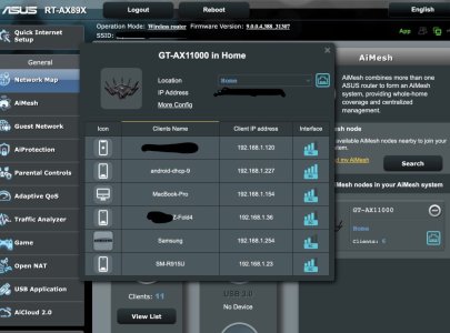

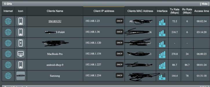

Heres what I'm talking about with a low phy rate.
Do you see similar low link rate reported on each client? Is each client connection reported in the router Wireless Log using the expected number of spacial streams (NSS), typically 2 or 3?

I've found on my 89X that the speed shown on the screen captures you posted wasn't completely accurate. Sometimes it was artificially low and sometimes it was artificially high. Have you guy a speed test on those 5GHz clients to verify they won't go faster than the speed shown on your router GUI?
I have and it generally correlate with the speeds that is listed on the webgui.
