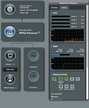

FYI, here is my memory usage after being up for a day or so after the latest update. RT-AX86U Gundam edition.
