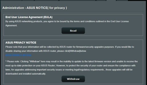

Whats this new privacy agreement?

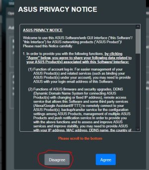

Honestly, I am a bit annoyed that the router now forces us to agree, without a warning that this has been included in the latest version of the software.
It is possble to disagree and opt out of the privacy notice in Administration -> Policy tab. Disagreeing didn't break anything for me, as far as I can tell, despite the dire warnings that it may break features (that I don't need). Since I'm relying on Asuswrt-merlin for security updates and not ASUS, "..inability to update to the latest firmware version and unable to receive the most up-to-date protection on your ASUS Router.." does not worry me.
Possibility of Government mandated forced updates (which government?) is a concern, but you get that in stock firmware in any case if you buy an ASUS router. Not sure if ASUS can override Merlin firmware with a forced update. I hope not. Does anyone know if Asuswrt-merlin is protected from government mandated updating?
Asuswrt-Merlin does not connect to Asus' firmware update server. And the code that actually downloads and apply a stock firmware is disabled at compile time, and replaced by my own code which connects to my server to check for any available update (by downloading a small text file containing models and their versions), with no auto-upgrade functionality.
You can disagree and the router will still work so you are not forced to agree with anything.
Yes, but there are warnings about things being disabled if you disagree. I need to review what this means.
Also, the new security updates, it seems the Router can be updated by Asus even if you do not agree to automatic security updates.
The update connections coming from Asus will be for the ASD malware detection signatures, and the Trend Micro signatures (if you accept Trend Micro's separate EULA).

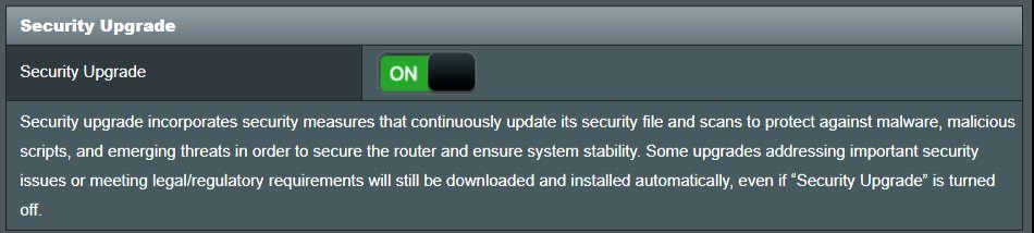

If you want to see an example of what each of the notices say, see my post here and here. What it boils down to is the following, or something like it, if one declines the Asus Privacy Notice:
Notice
Please be advised that disagreeing with ASUS PRIVACY NOTICE may result in the inability to update to the latest firmware version and unable to receive the most up-to-date protection on your ASUS networking products; However, to protect the security of your router and ensure the compliance with laws, for upgrades addressing important security issues or meeting legal/regulatory requirements , those upgrades will still be downloaded and installed automatically.
Declining certain information may limit the functionality of the following features that rely on that information.
Account Binding
Config transfer
DDNS
Alexa
IFTTT
Google Assistant
Remote Connection
Notification
As RMerlin indicated above, when using the Asus-Merlin firmware, Asus won't be able to auto update the router's firmware because that code is disabled or replaced in the Asus-Merlin firmware at compile time. What would can still be updated by Asus even if one disables the option is the ASD security feature. Otherwise declining the Asus Privacy Notice disables a number of features indicated above. If you attempt to enable them you typically get prompted with a notice asking you to agree to the Asus Privacy Notice. As always one can decline and "Withdraw" from the agreements on the Administration > Privacy (or Policy) GUI page.

Correct me if i'm wrong, but just for clarification Asus isn't auto updating the ASD security feature/Trend Micro signatures in the sense i think @Pocah.H is stipulating, that being Asus has access to his router. The router itself is just connecting to the Asus internet endpoints on it's own accord to update the signatures.
Correct, that is what appears to be the case. The issue is that even when the two settings are disabled ( stock firmware update and security update), the router may still update either if Asus (somehow) decides to force the update if the information in the various notices are correct. That I suspect is what people have a problem with. The router still potentially performing update actions despite the user disabling one or both of the update settings. The question is how, when, why does Asus decide to override those disabled settings and force the update?
As we've seen in the past an ASD update has corrupted people's routers. So it does cause one to have pause when such a feature can still potentially update itself, at Asus's (or Trend Micro's) direction, even when the Security Upgrade setting is disabled.
It would be really useful to get an update as to just exactly what it means when Asus say they can install security updates even if Security Updates have been disabled in the settings (in the latest firmware). Is this also invalidated by Asuswrt-Merlin ? I mean, isn't the ability to update, even if the user disables the option, in itself a serious weakness in the firmware?
ASD updated the same in previous FW (as bennor said it did wonky stuff in the past), just without the notice and switch button in the GUI. Trend Micro does not work/update if turned off/not accepted.
And yes ASUS can indeed force a security (ASD) update from their side too in case of need (major serious security risk, attack - exploited flaw) no matter if enabled/accepted or not, and this is not just ASUS decision but regulatory demanded as well (US, EU...).
I don't know what "security updates" specifically means. Just like every other EULA, it's written with the vaguest and widest possible range to please the lawyers behind it. It's written by lawyers ,not by software engineers.
