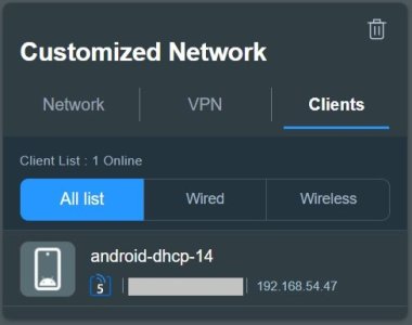

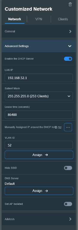

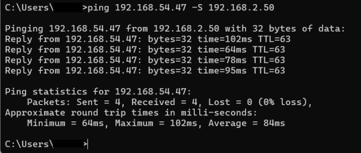

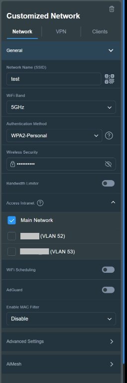

Did another quick test; setup a third Guest Network Pro profile, a Customized Network profile, with Access Intranet configured for Main Network, with Use same subnet as main network disabled, and it works. Main LAN client can ping Guest Network Pro client and the Guest Network Pro client can access main LAN client(s). See the three attached images.
Normally I have Access Intranet disabled on my Guest Network Pro Profiles.

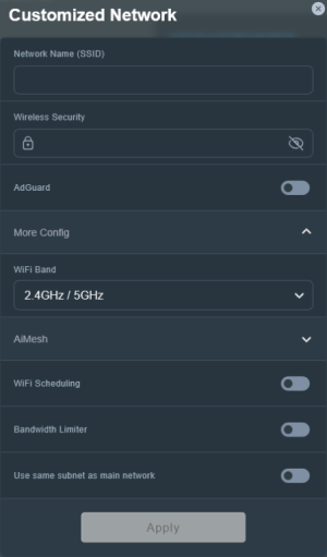

As a troubleshooting step (if you haven't done so already), setup a Guest Network Pro profile with Use same subnet as main network configured as enabled. That way Guest Network Pro clients pulls an IP address from the main LAN subnet. Then test if Guest Network Pro clients attached to that profile can access main LAN clients and vice versa.
In my testing (both with stock Asus and Asus-Merlin 3006 firmware), when having Use same subnet as main network enabled, it would cause Guest Network Pro profile clients and main LAN clients to have unrestricted access to each other (at least in my testing on a RT-AX86U Pro). Another quick test with Asus-Merlin 3006 just now shows this still to be the case on the RT-AX86U Pro using the Guest Network Pro Customized Network profile.

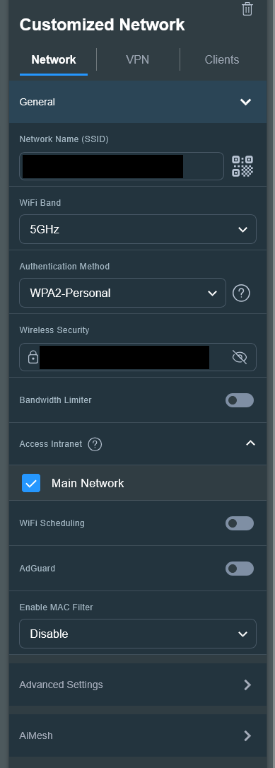

If I set Use same subnet as main network as enabled then the guest network profile clients reach the Lan network and vice versa.
As I commented at the beginning, I need a guest profile with VPN and communicating with the Lan. If I enable Use same subnet as main network and apply a VPN to the guest network profile, then the whole Lan is under the VPN, so this does not work for me.
For information AiProtection is disabled, I have no AiMesh nodes, I have no scrips running, I do not use Dual Wan, I do not have any sort of MAC black or white listing or WiFi scheduling enabled, no Pi-Hole, WPS is disabled and I have Smart Connect enabled (I have disabled it for prober and no change). All testing has been done with VPN disabled.
What strikes me is that when I create the Customized Network profile in Guest Network Pro, the option Access Intranet is not available, it only appears when the network is already created.
It is very strange.

Just tried a quick test on a RT-AX86U Pro (3006.102.4) that has a Guest Network Pro IoT Profile created that has Use same subnet as main network disabled and Access Intranet (Main Network) enabled, and the IoT client could access/ping several main LAN clients (both a wired client and a WiFi client). And a main LAN client could ping that Guest Network Pro IoT client.
